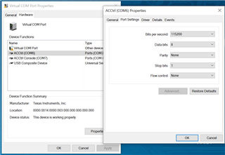

According to the User Guide I changed the Baudrate of the ACCtrl from 9600 to 115200:
But when I want to connect the GUI to the EVM nothing happens:

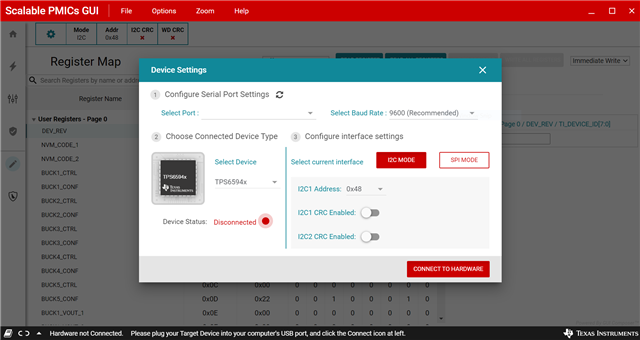

    I also tried to just Begin ealuating a Device with both Baud rates and I tried to set the jumper to VSYS connecting V3V3 an V5V0.
    In every case I get following message:
    Is there something I oversee or are there some background processes which might be blocked by some user policies?
    PS.: I'm unable to choose a Port in the Select Prot Dropdown Menu.

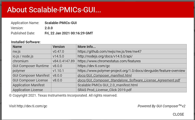

    Gui Version if this could be the issue:
    Is there something else which could be overseen or is the issue?

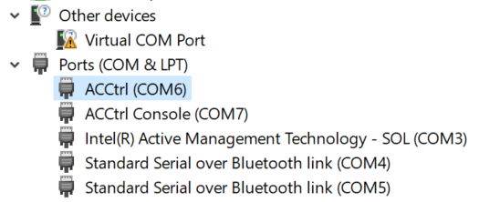

    From your device manager can you see the EVM?  This means that it has enumerated properly.
    If the ACCtrl ports are higher numbers and you have other devices which are lower, then can you remove them and retry?  In your earlier post you showed changing the properties, but you should not need to do that.  Once connected you can change the BAUD rate from the gui.

    yes I can see the device in the device manager:
    as you can see the device has higher COM port on my Laptop, but I cannot remove the lower devices because the only external device connected now is the Evaluation Kit.
    I also tried to connect the Evalkit when starting the GUI as Administrator (giving Admin rights to my account and also when an Systemadministrator tried) and this also didn't work. In the GUI I cannot choose the COM port in the select port dropdown menu.

  • Please see below the GUI with device manager properties shown just before:
  • Hello Thomas,
    Please remove the Bluetooth devices (disable the bluetooth on the machine).  We have seen this issue with other users.
    Chris
