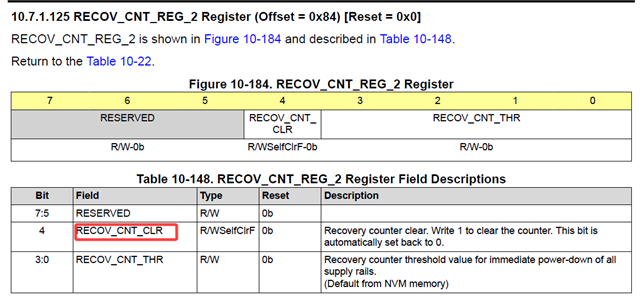

Hi team,
My customer is using SOFT_REBOOT to implement software reset of pmic. They found, after 15 times SOFT_REBOOT, the pmic will go into safe recovery state, even they clears the RECOV_CNT to 0 before it is up to 15.
Q1: Is that expected?
Q2: Should they use  SOFT_REBOOT to implement software reset?
