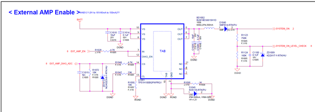

TPS1H100-Q1: [TPS1H100BQPWPRQ1] Inquiries related to 'GND Short Detection'
Part Number: TPS1H100-Q1
Hi, TI Support Team
I have received inquiries regarding diagnostics of TPS1H100-Q1 products from customers.
Please refer to the attached materials for detailed explanations and inquiries about the content.
Inquiries are written in blue letters on the attached sheet.

  • Hi MJ,
    Could you double check with the customer that for the measurement, did they measure against DGND or RGND? During the short-to-GND event, DGND might be shifted due to large current. The real CL voltage will be relative to RGND.
    Yichi
  • Hello, I'm Hyun Jun, Cho
    Does RGND mean IC GND? (Pin No.2)
    I tried shorting OUTPUT to the corresponding GND, but Vcs is output as 5.7V.
    The Vcs Max value of the IC is specified in the datasheet as 4.9V.
    The actual measured value and the spec do not match.
    Please check this part.
  • Hi Hyun Jun,
    Yes, did you measure the Vcs value against IC_GND? There might be a shift in voltage between the IC_GND and the GND.
    Yichi
  • Hello, Yichi
    Yes, I shorted OUTPUT to IC GND.
    When shorted, Vcs voltage was 5.7V.
    As I said above, it does not match the Vcs,h specifications of the TPS1H100. please check.
    Best regards
  • Hi Hyun Jun,
    Could you check if my understanding is correct? From the schematics you attached, there's DGND (GND) and RGND (IC_GND). When you short the output to the IC_GND, how did you measure the CS voltage? Is it from the read out at EXT_AMP_DIAG_ADC? If that's the case, then the voltage you're reading is referring to DGND. Could you manually probe the voltage using oscilloscope with positive at CS pin and negative at RGND (IC_GND)?
    Am I understanding the situation correctly or could you elaborate on your measurement of the CS pin voltage? Thank you!
    Yichi
  • Hello, Yichi
    I will answer your questions as follows.
    1. TI Question :
    1-1. Answer :
    The measured point is the CS Pin (Pin No.14).
    (I measured the only CS Pin voltage because the voltage value of EXT_AMP_DIAG_ADC eventually follows the voltage of the CS Pin.)
    And the CS voltage was measured refer to DGND.
    2. TI Question
    2-1. Answer :
    Are you talking about taking the IC GND as the reference and measuring the CS voltage?
    When IC GND is the reference, the CS Pin voltage is as follows.
    1. Short circuit to IC GND: 4.77V
    2. Short circuit to DGND: 4.77V
    When measuring CS voltage, is the reference RGND? Are you DGND?
    The Max 4.9V specified in the datasheet is based on what GND?
  • Hi Hyun Jun,
    The datasheet value should be referring to the IC_GND (DGND). If the voltage over 5V is a concern, then it would be good to use a Zener diode at CS pin to clamp the voltage to be under 5V to not damage the microcontroller pins.
    Yichi
