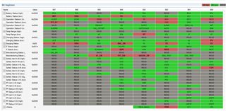

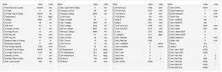

When I checked the SDV alarm, the cell balancing was broken.
Upload the GG file and the status window.
   1)  Is the setting wrong?
   2)  If the battery continues to be used without relaxation time after charging, does Pure Gauge not do cell balancing?
   3)  Is there no automatic recovery for SDV alarm?
   4)  If cell balancing is out of whack like this, how long does it take to rebalance?

    You should clear all your protection cases before cell balancing, it looks like you have update status as 0x0E which means cell balancing is allowed if it is enabled.
    CUV protection is also triggered, one of your cells is at 711mV and the other is over 2800mV, this kind of unbalanced is extreme and the pack should be permanently disabled and not try to cell balance.

  • Hello Keller
    You captured the Status window incorrectly. To correct, it was not an extreme voltage deviation.
    But why doesn't recovery work even after charging?
    Since voltage deviation did not occur while writing LOG, I do not currently have LOG.
