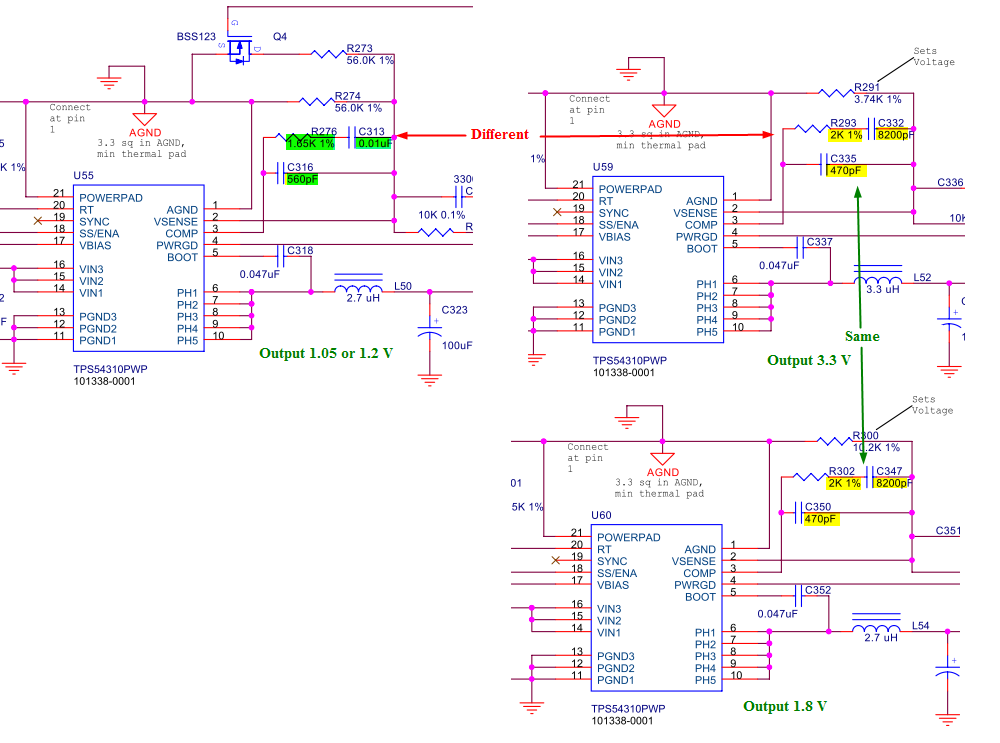

I would like to ask a question on 54310 compensation network.
On a design I am referencing (SpectrumDigital EVM6437), I noticed that
Output voltage
Compensation network
1.05 or 1.2V
1.65K, 0.01uF  ||  560pF
3.3 V
2K, 8200pF      ||  470pF
1.8 V
2K, 8200pF      ||  470pF
How are these compensation network components determined?
1.    According to SLVS412d (54310 manual), output voltage is determined by R4 and R5 as in Fig.10 of the manual schematic. So do I still have to adjust compensation network after output voltage is determined/
2.    If different output voltage corresponds to different compensation network, why 3.3V and 1.8V share the same set of compensation network element values? Is there any mistake here?
3.    For 1.05V/1.2V case, after changing (selecting) the output by changing resistor values, does the compensation needs to be changed?
I am bewildered by the large number of equations in SLVA109 - Designing With the TPS54310 Synchronous Buck Regulator, can there be any quick solution on these value determination?
Bob
  • Unfortunately, there is no "easy solution".  The TPS54310 uses voltage mode control with external compensation.  This makes for a very versatile control function that can accommodate  most any type of output filter.  With voltage mode control, the output voltage can be set using just the lower resistor in the resistor divider network.  That resistor is not in the small signal path, so you can change the output voltage without affecting the compensation.  If the output filter is identical, then you can theoretically use the same compensation for any of those output voltages.
