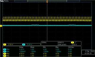

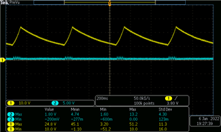

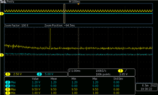

    Please see the figures below.
    Figure 1: C
    hannel 1 is VDD pin and channel 2 is DRV pin.
    Figure 2:
    Channel 1 is CS pin and channel 2 is DRV pin.
    Figure 3:
    Channel 1 is VS pin (between RS2 and ground) and channel 2 is DRV pin.

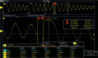

    Figure 4: Zooming in figure 3 - Channel 1 is VS pin (between RS2 and ground) and channel 2 is DRV pin.
    Can you find any abnormality in these figures?
    This voltage peak on Figure 4 is always occurring on the VS pin.
    Do you think the problem might be this? If that's the issue, how can I resolve this issue?

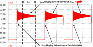

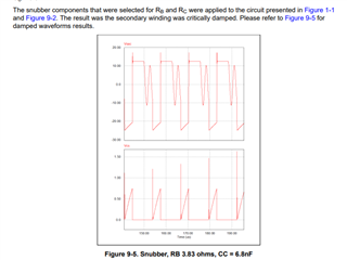

    You need to look at the switching waveforms before shutdown with higher resolution to see why you are shutting down.
    Problematic aux winding noise causing issues.
    Snubbing and RCD clamp will clean up the aux waveforms. Application note SLUAAC5 gives details on how to evaluate and resolve fault issues.
    https://www.ti.com/lit/pdf/sluaac5
    Most common issues are aux noise that can be resolved with and RCD clamp and a snubber across the output rectifier.  Those circuits are highlighted below in green.

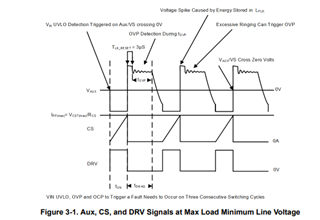

    The UCC28740 gives three sample pulses when it reaches VDDon at the maximum switching frequency if fault is observed it will stop switching.  Trigger on the DRV output and you should see these pulses.
    Look at figure 4-1 in the application note I referenced.  It discusses the three sample pulses.

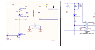

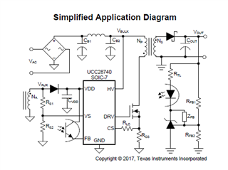

    See the figure bellow.
    On the left we have my circuit, on the right a circuit found on the texas website.
    Question: Some designers do not consider the TVS diode (D2), see the figure on the left.
    Could you please tell me why the designers don't consider this TVS diode?
    The circuit on the right is an RCD clamp.  The circuit on the left is a transient voltage suppressor (TVS) clamp (D2).  There are high voltage Zener type diodes that are specified as TVS (D2).  You can find TVS diodes at most of your semi conductor suppliers.
    Can I remove diode TVS (D2) and add an RCD clamp? Just for a test.
    Both should protect the FET from an over voltage.  The application note that I sent you shows that the RCD clap is preferred.  Putting a TVS across the R and C in an RCD clamp can be done for safety.
    Mike

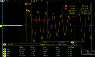

    But I have a many quetions. See the figure bellow. We have a TLK_Reset and T_OVP representations.
    Figure 1; TLK_Reset and T_OVP representations.

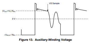

    Question 2: It should be VS Sample = (Vout+VF)*NA/NS=(5+0.55)*2.667~=15V. Is it correct? Look at next figure for it.

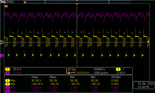

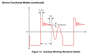

    Question3:
    in figure 3 which point represents VS Sample in figure 13? Point 1 or 2?
    Figure 3
    TLK_RESET is a blanking time and you will not check for OVP at that point.  You will check for OVP after TLK_RESET times out to the sample point.
    Please note TLK_RESET.  Page 14 and 15 in the data sheet escribe how TLK_reset could be 600 ns to 2.2 us based on the primary peak current level.
    I did post the information below but was unable to improve the resolution.  However, you can go do the data sheet to see the same information.
    https://www.ti.com/lit/ds/symlink/ucc28740.pdf
    If your output voltage is not coming up during the dmag time the aux winding should not be reaching 25 V.  Maybe the polarity of your transformer connections is not correct or your turns ratios is off.  Because Vout*Na/Np should roughly be Vaux during the dmag time. If Vout is zero the voltage at vaux + should not be 25V during the dmag time.  It should be closer to 0 volts.
    Double check the transformer turns ratios Np/Ns and Na/Ns secondary to make sure they are correct as well.

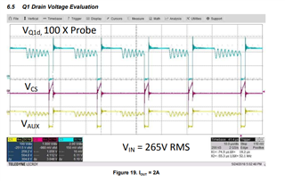

    In regards to your figure 3 the waveform does not look correct.  The resonant ring should be uniform and should resemble figure 13.
    The waveforms below came from a working a design
    Your waveforms the sample is taken at 1.  Not sure what is causing waveform between points 1 and 2.  I wonder if something is breaking down in your design causing the output voltage to deplete.
    I would suggest probing Aux, CS, and the secondary winding and output voltage during this behavior.  Maybe it will help identify what is breaking down.

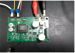

  • Dear Mike.
    My circuit is working perfectly. All voltage levels are correct as described in the datasheet. Everything is working perfectly. Thank you for all your support during this step. Texas Instruments is amazing. Thanks a lot for all the support.
    Wagner Coelho Leal Researcher in Sustainable Energy at Certi Foundation - Florianópolis Brazil.

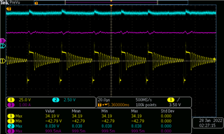

  • Hello Mike,

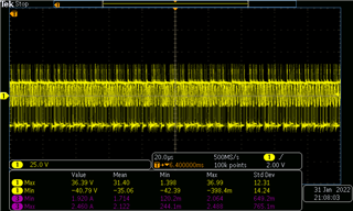

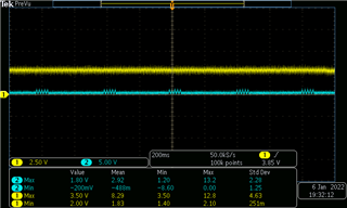

    Channel 1 is Vaux and Channel 3 is Iout.
    I'm noticing that the switching frequency is not constant. See the "a" and "b" points.
    Question 1: Is this normal to happen? Is that correct? If it's not correct, how can I improve?
    Question 2: I expect to have 2 A at the output. See that it is oscillating between 1.96A and 2.46A.
    Is this normal to happen? Are these oscillations because of the switching?
    The design have frequency jitter to lower EMI.  It will vary roughly +/- 8 to 10%.
    So, are my measurements correct?
    The circuit does modulate the peak current to modulate the frequency.  However, your output current should not be showing the different in peak current.  This AC current should be going through your output capacitor.  This different in current may have to do with the load you are using.
