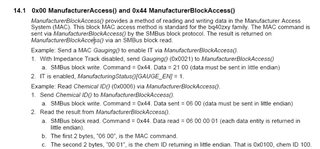

Presently i am doing the initial Testing stage of BQ40Z50EVM. Know, I Used example of  Advanced SMBUS in the Technical Reference manual  for reading chemistry ID using BQSTUDIO Software.  I am getting different chemistry ID output Format In SMBus Read Block other than Which is given the TRM. What is the issue here.
please find the attached log File of Advanced SMBUS, and Data memmory File below.
Thank you
Muhammed Rafi c k
Advance Comm SMBus Transaction Log
TimeStamp , Address , Operation , Command , Length , Data , Status ,
2021-12-16 05:40:14 169 , 17 , Wr Block , 44 , 2 , 06 00  , Success
2021-12-16 05:40:17 113 , 17 , Rd Block , 44 , 6 , 54 00 80 61 00 00  , Success
