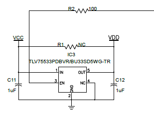

TLV755P: an inrush current at Power ON
Part Number: TLV755P
Dear Sir/Ms.
My customer does the LDO startup test on his product. He found that  the current of Iout will be very large when the voltage of Vout is rising (Power on). Peak=728mA, the time exceeding 500mA is 220μs.
Is this phenomenon normal?
The following is the customer's circuit diagram and the test waveform.
We probe VCC, EN, VDD, Iout
