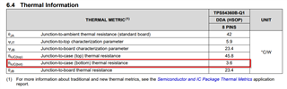

Do we have power consumption vs thermal curve at room 25℃/85℃?
since customer have concern about he thermal resistance at junction to case is larger than junction to board.

Since the part have thermal pad, it will propagate the heat from the die to the bottom thermal pad of the package
The thermal resistance is lower in this case compared to the thermal resistance going up to the package. Then the thermal will propagate through PCB.
Webench can also be used to estimate the temperature of the IC for a given operating condition
