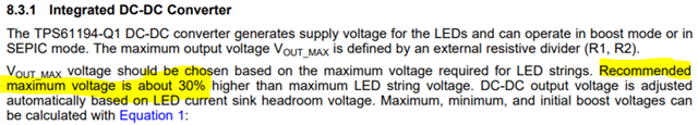

We found below words in datasheet.
Is it essential to set 30% higher than maximum LED string voltage? We want to set maximum LED string voltage + 2V because 30% higher will exceed max Vout of TPS61194-Q1. Does it have any risk?
Thank you.
