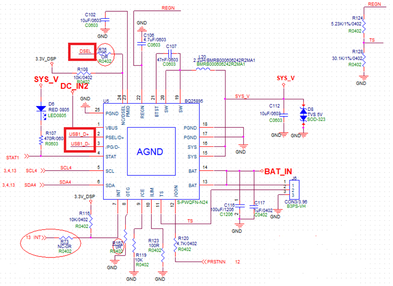

Dear Sir,
My customer wants to use D+/D- of BQ25895 to monitor and control the charging current.
The power source is from USB typeA port input and the test method as below.
1. PC power on -> attached device and power on it -> charging from USB port with 500mA (customer think OK).
2. PC power on -> attached device and keep powered off -> charging from USB port with 1~1.5A (customer think it will have risk)

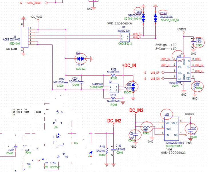

Customer now uses TS3USB221 and DSEL pin to control D+/D- while device powered on and off as below schematics.
IS this design OK to not?
Thanks.
    1.D+/D- pins are used for USB input current limit detection when VBUS power is plugged in. During the charger input current limit detection process, the host must be able to HIZ D+/D- pins so that D+/D- pins are driven by the charger. If the host is unable to HIZ D+/D- pins, a USB switch is needed to isolate the host and the charger. The DSEL pin of the device can be used for D+/D- multiplexer selection control. Please refer to the EVM User’s guide at https://www.ti.com/lit/ug/sluuba2b/sluuba2b.pdf for sample circuitry.
    2. If the desired D+/D- input current detection result is 500mA, it is ok to leave D+ and D- pins open.
