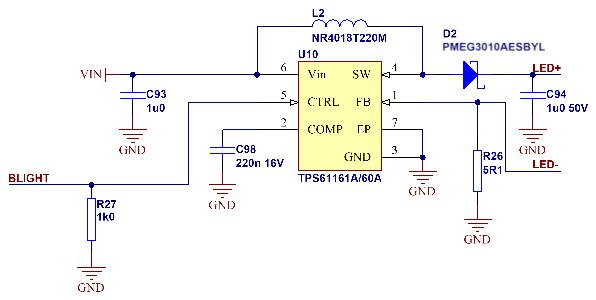

The circuit is the same as shown on the datasheet except Rset is 5R1 (current at 40mA).  The CTRL pin is connected to the micro and has a 10k pull down resistor.
The issue is that sometimes after a powered up reset from say, an Over the Air update, the TPS61160 stops working, let’s say locks up as there is no recover from it other than a full power cycle.
My question is what can we possibly be doing during the “warm” reset that could be locking up the TPS61160?  The power supply to the TPS61160 is not removed, the only thing is that during the “warm” uPC reset, over which we have no control, that the CTRL pin does something odd which upsets the TPS61160.
Any ideas? Thanks.

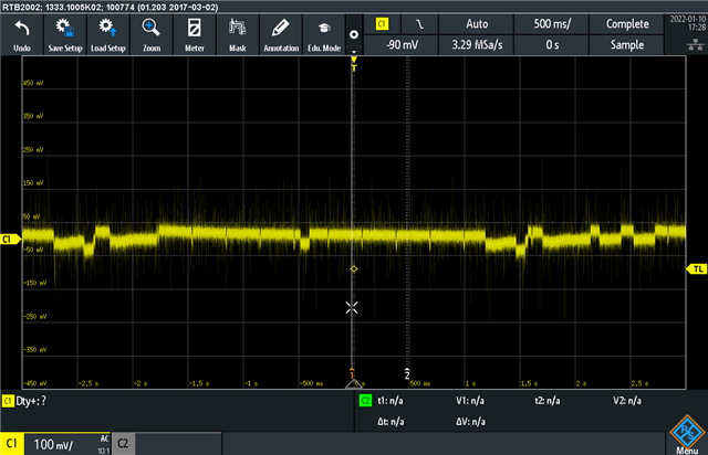

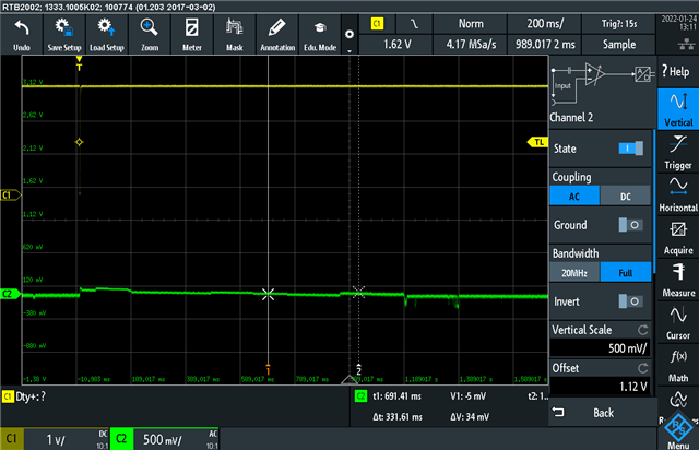

  • Hi Mason,
    12V picture attached,. AC coupled, 100mV / div, 500ms / div.  Once I get the trigger sorted, I will get the other picture.
    But just to clarify.  The power supply is 12VDC and varies by less than 100mV at any time.  The only other thing is that the PWM Signal going to the CNTL pin is an asynchronous reset, ie. we don’t know where in the cycle it maybe when the Reset Occurs.
    I agree with you re the lockout on the control pin, but it is either that or the Power Supply.

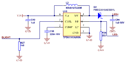

    Circuit for your reference. Thanks.

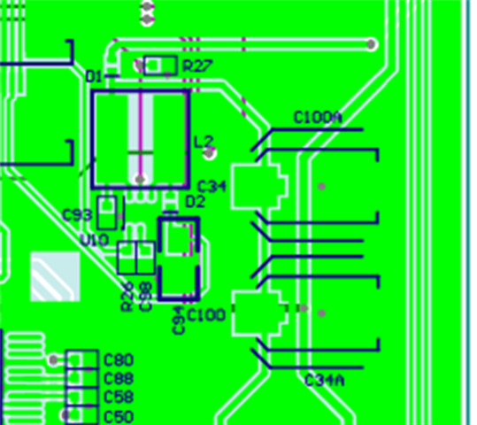

    One other point I should make is that different PCBs act differently, I have ones which will only fail occasionally and others that almost never work.
    Here is the layout of the PCB. PLEASE NOTE there is a complete ground plane on this layer and on the bottom layer and Schematic

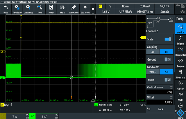

  • Hi Mason,
    Please see our comments below.
    Is it available to attach the waveforms as we discussed?

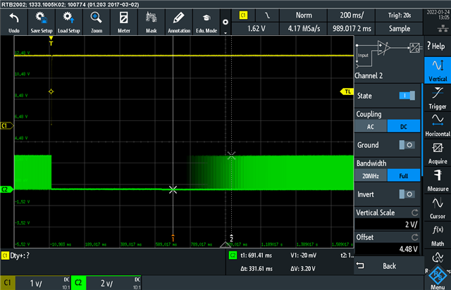

    Attached - File names are description PWM Stop and Restart thru Reset 1 and 2 are one failure and one OK and as you can see there is no obvious difference.
    You are right. The latch-out that needs repower to bring it back is not clearly described. The device should be recovered when current or voltage is back to normal range, there is no need to repower.
    Concur it should but doesn’t.
    TI AE had found some information from another device that the sequence of power on Vin and applying PWM signal will have impact on the start-up of the device. Have you ever tried to apply input voltage first and then PWM signal? I guess most of the time PWM signal is given firstly and then the input voltage at your side.
    From Power up Supply is there first and 800ms later the PWM starts.  During RESET and On/Off Vin is never removed.

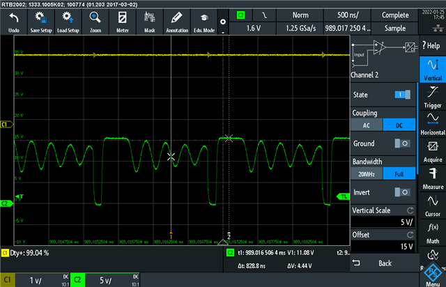

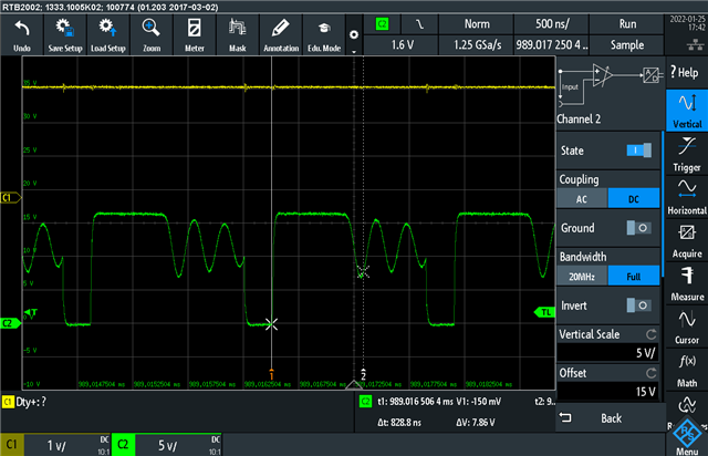

  • Hi Mason,
    2 More Pictures of switching wave form (Pin SW)
    SCR11 is higher brightness backlight and
    SCR12 is lower brightness.

    1. what does channel 1 represent in the first two waveforms?  is it 3V3power supply for MCU? I guess channel 2 is Ctrl pin voltage. And the second is the zoom in result of the first result. Waveform #1 & #2 reset, #3 PWM stop.

    3. To make it clear if anything odd on Ctrl pin, Is it available to break the connection of MCU and Ctrl pin before over-air update first, and keep other operation condition the same. After over-air update, reconnect MCU and Ctrl pin and see if everything is ok.
    4. please help clarify the input voltage, output voltage and inductance, not clearly given in the schematic. I will check the SW results you updated just now. CH1 is?

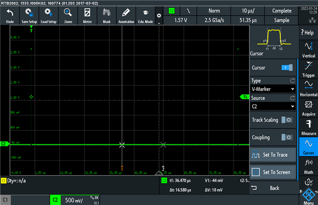

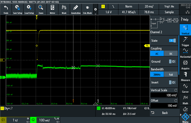

  • Hi Mason,
    I am not sure what you are asking me in the first two questions.
    Descriptions
    PWM Stop and Restart #1 and PWM Stop and Restart #2 are a good restart and a failed restart Channel 1 is RESET Pulse (Trigger point “T” on top)
    12 Supply at Reset shows 12v (AC Coupled @100mV/div)
    12 Supply at Reset Shows the same as above (@500mv) just over a longer time, backlighting would restart about 800ms after Reset (Channel 1 and trigger)
    PWM Stop at RESET shows PWM signal (Ch 2) and Reset (Ch 1)
    PWM Start shows the first 2 pulses that are on the CTRL pin after Reset (approx. 82us apart and of 320ns duration [82us / 255])
    3:            I have done that by connecting CTRL to ground and releasing it after processor restarts it still fails. Not every time but it does.
    4:            Vin 12VDC, Vout is about 16-17V (see Vpeak on SCR11/12), Inductor is 22uH, 432mΩ, Isat 800mA made by Taiyo Yuden.  I have a SRR4028-220Y Bourns Inductor arriving to swap just to be sure. (22uH, 185mΩ, Isat 720mA and shielded).  In SCR11/12 Ch1 is not connected.
