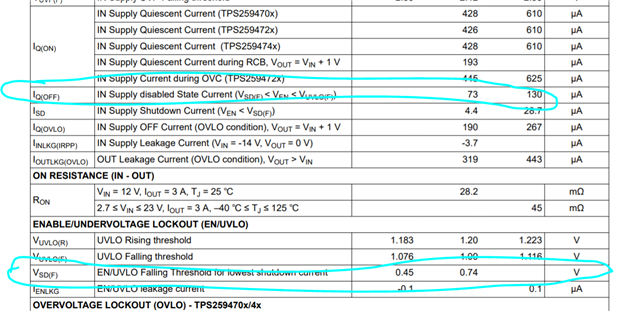

TPS25947: High Quiescent current
Part Number: TPS25947
Other Parts Discussed in Thread: TPS25940
I am considering this part number for a product our company is designing - The problem we have with it is what seems to be the very high quiescent current by battery protection IC standards (I know this isn't designed specifically as a battery protection IC) - could you give me an explanation for why this current is high (about 420uA) and if there is a way to lower it? I'm sure I'm missing something important but would be very grateful to have it explained to me.
Karl
