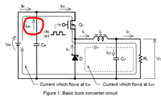

Could you give me the buck converter input ripple current formula derivation ?
Hi Nick,
Following two app notes can help you to calculate the output ripple of buck converter. it mostly depend on many factors like device capacitators, inductor and duty cycle selection. If you looking for particular device buck converter ripple requirements than I would suggest to use Webench model. It can help you to give data for all operating conditions.
https://www.ti.com/lit/an/slyt293/slyt293.pdf?ts=1640593542547
https://www.ti.com/lit/an/slva057/slva057.pdf?ts=1640593552829
Hope this can help!
Tanvee
Hi Nick,
I misunderstood the question.
The formula you have mentioned will give you the expected input ripple current RMS. This formula is well explain in this app note. https://www.ti.com/lit/an/slyt670/slyt670.pdf?ts=1640595281717&ref_url=https%253A%252F%252Fwww.google.com%252F
