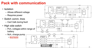

Dear Teams,
Could I ask why it will have leakage current when customer use SMBus to communicate between system host and gauge/battery host uC? Could I said it is most like there has a isolation opportunities if customer system use SMbus for low side protection with communication?
Thanks!
