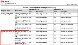

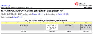

We have found that the register MASK_READBACK_ERR has two fields in the  datasheet (shown in figure1), but there are four fields in the User's Guide (shown in figure2).
register in datasheet register in User's guide
Please confirm which one is the correct vesion, and please provide us the initial Static NVM settings for referance.
Look forward to your reply. Thank you so much!

  • The correct version is the datasheet although the values for those named fields in user guide is correct. Between initial pre-release and the final RTM of the device the register slightly changed. The fields "NINT_READBACK_MASK" and "NRSTOUT_READBACK_MASK" were moved to the MASK_MODERATE_ERR register as reflected in the datasheet. Again the values of those two fields is correctly reflected in the user guide, the location needs to be updated.
    An update to the user guide will be made shortly.
