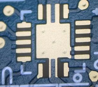

TPS54620's data sheet has 2 package: RGY and RHL, I looked at the drawings, looks like all the dimensions are identical between the 2 (unless I overlooked something)
So what is the difference between RGY and RHL?

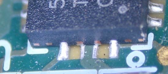

There is no difference between the 'custom' RGY leadframe of the TPS54620 and the RHL. The 'standard' RGY package does not have the 'wings' you see in teh outline drawings.
TPS54620RGY
Why did the RGY package changed to be identical to the RHL?
I got a design that was created with the original 'standard' RGY PCB footprint.
The RHL package has 2 pins associated with each of the 2 'wings'. What is the impact of not having those 'wings' connected to ground?
