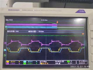

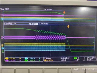

We found that when ucc28950 shut down is abnormal ,like below. Input 200V-400V utput 28V ,1200W .
Purple is transformer current,
Green is the output voltage waveform .
Channel 1& 2 is drive waveform.(High side and low side half bridge )

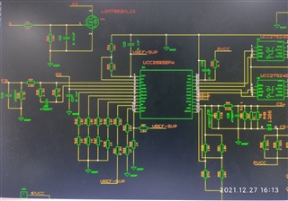

This is schematic.
