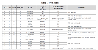

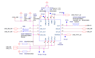

As a standard application for us, we use "1111" configuration for CTL and ILLUM_SEL pins. CTL1 configured as logic high by SW and others hardwired to logic high.
According to datasheet , charger should be configured as CDP mode with "1111" config and it can automatically switch to SDP2 .
We checked almost 20 newly phones and only S20 didn't charge in this configuration.
When I checked 0110 configuration(with rework)(DCP auto), S20 charged with almost 500mA. Data lines disconnected. Vbus discharged.

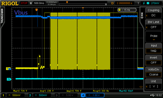

    As you can see at below Figure1, primary detection and secondary detection correctly performed with S20. Then charging and enumeration started . After the enumeration charging was stopped. You can observe indirectly charging current on Vbus voltage drop at Figure2.
    Summary, If we use only charge cable(no physical data lines), it started to charge. If we use DCP mode it start to charge( data line disconnected). If we use CDP or SDP mode with data + charge cable, it start to charge and enumeration. After enumeration, charge was stopped.

    Figure1 : CDP Mode/ Samsung S20

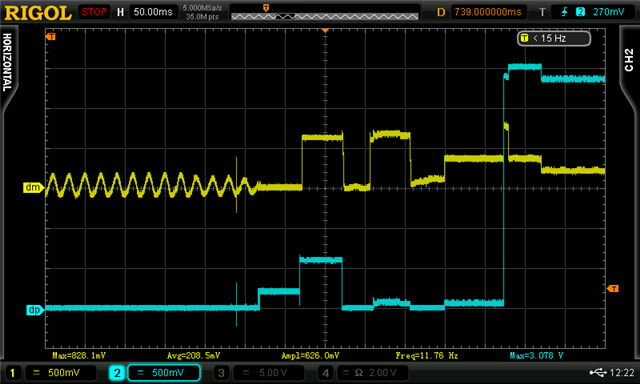

    Figure2 : CDP Mode / S20 / Vbus Monitoring(Dp not measured)
    In your second figure with the CDP charging, VBUS seems to drop to 0V after a period of time. Is this due to something on your end? i.e removing the probes while the scope is still capturing.
    Are you able to capture the FAULT pin in addition to VBUS/DM? The FAULT pin is active low so I am curious if this is triggering before VBUS drops low.
