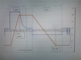

    Due to some reasons they cannot provide the log files, but they have made the following charge and discharge graphs with log file:
    16.8V cutoff voltage during charging phase, charge to around 16V SOC has reached 100%, but can continue to charge to 16.8V, discharge phase 11V cutoff voltage, to about 13.5 V to 7% and can continue to discharge SOC no longer falling). Design capacity of the final 5000 mAh, while the FCC is only around 4400, but the discharge cap in the bqstudio interface is around 505050mAh:

  • Hello Cherry,
    The battery parameters must be matched to the actual termination condition. Set appropriate taper values to get correct SOC during charge. I think the mismatch in discharge may be because the battery was charged beyond 100% which is not tracked by gauge.
