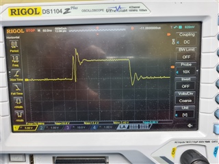

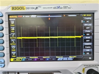

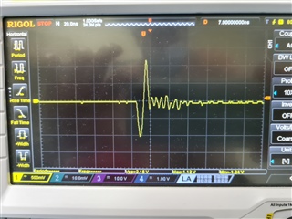

we bought the evaluation board LM5122EVM-1PH to check the output signals and mosfets gates signals. The evaluation board seems to be ok, the output spikes are about 200mVpp.
We tried to replace almost all the related components on our board using the components mounted on the evaluation board (input and output capacitors, compensation network, mosfets, sense resistor, frequency resistor etc... the result is that on our board the spikes are about 1.5Vpp, almost the same behaviour using our designing components. What can be the origin of this issue? It is more than 2 months we try to solve.
