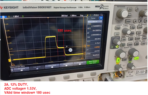

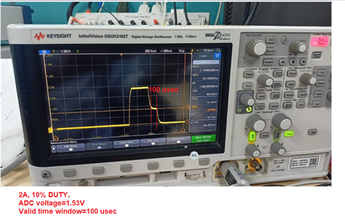

My customer is using the TPS1H100-Q1 and is noticing a large discrepancy in what they're calling the "valid time window" for taking their CS measurement under two different load condiitons:
Case 1 - Iout = 2A, Duty Cycle = 10%:
Case 2 - Iout = 2A, Duty Cycle = 12%:
As you can see, they've noticed an 80us discrepancy between a 12% and 10% duty cycle change off of a 2A load. Note that the reason we believe we are seeing Vcs hit it's fault voltage initially is because the load is being provided by an e-load in CC mode, which I've been informed can interfere with the CL circuitry on start-up.
Can someone help me understand why we're seeing such a large discrepancy in this "valid time window" between these two load conditions?
