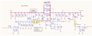

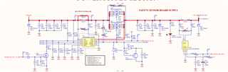

Here are the final designs:
48V, 3A Schematic:
48V, 3A LM5069 Calculator:

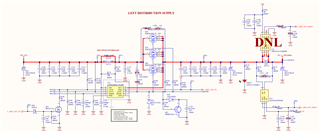

48V, 30A Schematic:
48V, 30A LM5069 Calculator:
