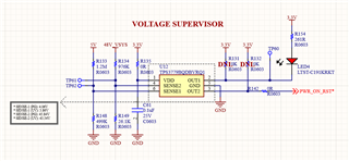

Need design review of the below design:
The only issue with the schematic is that the LED diode has a R154 for 261 Ohms. At a fault condition, this will be close to 8-9mA through OUT1. The max current is 5mA for this device. Please increase R154 accordingly to be below 5mA.
