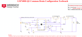

Please review the customer schematic.
OVP : 37.6V
UVLO : 19.7V

  • Hi Cho,
    Please see my schematic review comments below,
    1. The FET selected is only 40V rated. If this is an Automotive application, we would recommend using at least 75V rated FETs are recommended along with SMBJ28A and SMBJ58A connected back-back at the input. For more understanding on this topic, please refer to '11.3 TVS Selection for 24-V Battery Systems' section of the datasheet.
    2. With 110 kohms and 6 kohms resistor ladder on the EN/UVLO pin, the EN rising threshold = 23.79V and the EN falling threshold = 21.88V
        With 110 kohms and 3.74 kohms resistor ladder on the OV pin, the OV rising threshold = 37.4V and the OV falling threshold = 34.36V

  • Hi Praveen,
    Thank you for your reply.
    Please give us a guide on the calculator or calculation method for the second content.
  • Hi Cho,
    It is a simple resistor divider network. So, the calculation is straight forward.
    For example, lets take EN/UVLO. There is a resistor divider from Vin to GND. R9 = 110 kohms, R10 = 6 kohms.
    To calculate the EN/UVLO rising threshold,
    Vin (R10/(R9+R10)) = 1.231 V
    Vin (6k/( 110k + 6k)) = 1.231 V
    Vin = 23.79V
    To calculate the EN/UVLO falling threshold,
    Vin (R10/(R9+R10)) = 1.132 V
    Vin (6k/( 110k + 6k)) = 1.132 V
    Vin = 21.8 V
