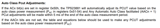

While powering on the channel in auto/semi auto mode, we wanted to use auto class auto adjustment mode enabled as per 0x50 register.
Could you please let us know, in case of auto class auto adjustment mode enabled what are the values set for PCUT threshold or Pac Margin?

    As described in TPS23881 datasheet, when AAC bit is set, the port PCUT value will be set to the measured autoclass power in register 0x51 to 0x54. Thanks.

  • Charan,
    The police configuration registers(1Eh-21h, 2Ah and 2Bh) are the ones we set PCUT values. the power margins are only needed to be considered if you want to manually set PCUT value based on autoclass power measurement. If the AAC bits are set, you don't need to worry about the PCUT setting. The TPS23881 will take care of it by itself. Thanks.

  • Hi Charan,
    How long is your ethernet cable? Can you try to reduce the load power and see? I think the total power PSE sees (your load power 30W + cable loss) already exceeds the PCUT.  For an IEEE compliant PD, the maximum power consumption is 25.5W to counter for the cable loss. In addition, the TPS23881 has the below PCUT tolerance spec. Thanks.
