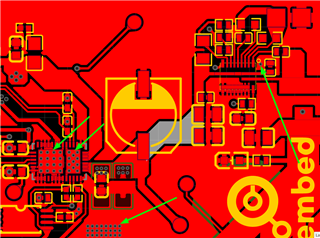

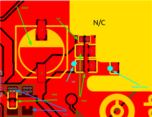

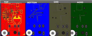

Here's the board layout for the buck converter. This is a two-layer board

  • M,
    I would also like to mention that on the second layer (blue) the Vin capacitor is not connected properly to PGND. There is a trace that is separating the input cap from PGND. Additionally, there are no vias near pins 11 through 18 as recommended.
    Please refer to Section 10-1 in datasheet for further inputs on Layout Guidelines
    Alejandro

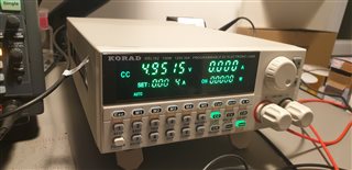

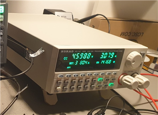

    First of all, we now have a programmable load here which we used to test the USB-C PD chip. We were able to first test the USB-C PD chip. Using the TPS25750 Application Customization Tool I configured the chip to output 15V - The maximum power for this voltage seems to be 45W.
    We overloaded the chip and we were able to trigger the overcurrent protection at about 51W. Thus, we were able to draw 3A as per the application design. However, the voltage suffered a bit and fell to 14.3V. Is this to be expected?
    Here's proof:
    There was a lot of troubleshooting with the above chip and we're glad to know it now works correctly.

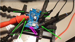

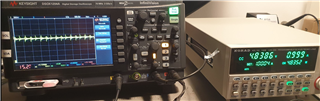

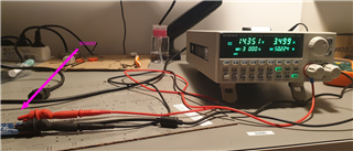

    This is my test setup now:

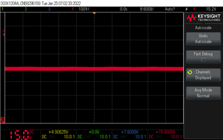

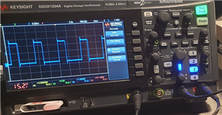

    We used the same load, but this time on 5V, and ran all the tests you required for different current loads. I took a picture of the load screen which shows power, current, and measured voltage at the load. It's a matter of making sense of the numbers and understanding the behavior now. In this order I will attach captures from the oscilloscope: 5V(Yellow), SW(Blue), 15V(Red)

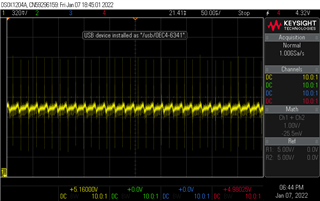

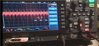

    NO LOAD:
    LOW LOAD (.4A):
    After I was sure it can surpass .4A (and presumed 200mA that would break it), I really started pushing it.
    .7A
    1A:
    1.5A:
    2A:
    3A:
    When I tried to jump to 4A the buck popped at around 3.7-3.8A. As before, after failure, the GND, SW and VIN (PPHV) are shorted (0 ohm internal to the chip).
    My observations are that the noise increases in all 3 probes with the increase of drawn current. The most dramatic change happens with the 5V line which also drops in voltage considerably (4.6V at 3A). Not sure it should behave like a lipo battery Disappointed
    Those are my results. Please let me know what you think.

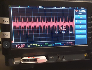

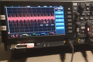

    Thank you for the very detailed message. Our speculation is pointing to the USB-C PD chip, TPS25750.
    The output of TPS25750 is very noisy and should not drop in voltage when supplying 3A to the buck converter. The input to the buck should stay within ~15Vin (voltage should drop at over-current limit though). Unfortunately, I am not familiar with TPS25750 device. It belongs to a different department. For the meantime, I would like to further comment:
    • make sure the output is being measured properly with correct probing techniques. Example, the tip-and-barrel technique. Improper measuring techniques can result in exaggerated output noise.
    • All outputs are VERY noisy.
    • Double-check there is sufficient output caps as recommended for TPS25750 application.
    For the layout, we just want to point out two things: (1) There are no vias for either power or ground planes. It is recommend to follow as instructed in Section 10.1 guidelines of datasheet. (2) The planes/traces for input cap C43 are not properly placed. The ground plane is very closet to the power plane pad (bottom-left of image with arrow).
    Alejandro

    I will try to redo the tests using tip and barrel. I have to admit that I used one of the probe's ground alligator to connect to GND and the hooks to connect to the probing points. This makes some 3 meters ground loops.
    I guess the noise should be reduced once I use tip-and-barrel but I will not assume that just yet.
    I will post my new measurements here and then further investigate the USB-C PD side.

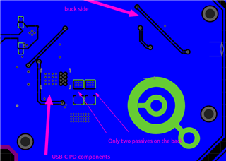

    I have to say - I'm also confused when judging the choice of traces I made back then (the buck circuit wasn't a fresh design). I added the comments about the vias in the GND plane and the spacing between the input capacitor input and GND.

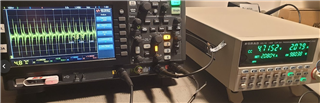

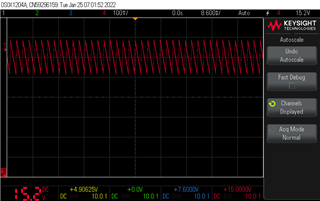

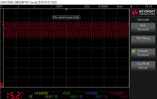

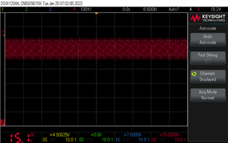

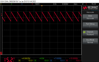

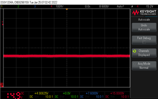

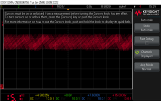

  • Started using the tip-and-barrel measurement method as you instructed.
    The items in the yellow polygon are not connected (including buck etc) in order to eliminate causes of noise/voltage drop.
    This is the setup:
    The probe (tip and barrel) is at the cyan points (VIN/GND). The measurements:

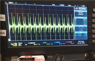

    0 laod
    .1 A
    .2A
    .5A
    1A
    1.5A
    2A
    3A

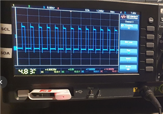

    I also observed this "flatlining" happening after 1.5A was drawn. Not sure why it happens.
    How does the noise look now?
    I will return with some tests on the buck converter side. Unfortunately when I surpass 3.7A as said before I have to resolder new chips to the board and this takes time. Fortunately, the USB-C chip just shuts down the circuit at overcurrent.

    PCB layout is a huge influence on performance of device. The SW line must be as
    short and wide as possible. My next steps was to get more info the traces, but you read my mind. Thank you for the details.
    Apologies -- let me clarify on my earlier comment: I didn't see any vias connecting PGND plane from Layer 1 (red) to Layer 2 (blue). It is highly recommended to have at least 6 PGND vias placed to minimize parastic impedance and lower the thermal resistance. How is Layer 1 and Layer 2 PGND connected? Also, in the previous image I attached, I circled the area in which I do not see proper layout routing techniques. The different copper planes (PGND and PPHV) are relatively close to each other. Notice
    how PGND plane is very close to bottom-right corner of C43 pad. I hope that cleared things up.
    Alejandro
  • I have to admit there's only one via on the buck side. On the USB-C PD it seems I respected the guidelines and I installed the vias through the large pad and later another pack of vias to the right of the chip. See attachment.
    As before, I admit the placement of the electrolytic capacitor is rather questionable -  Unless this is the cause of the misbehavior of this board, which is a prototype, I intend to find the setup which would make the prototype work and then repair the mistakes made in a future release.
    Do you think the voltage drop from the buck is what's causing the buck converter to malfunction? The drop is 0.1V at 2A which means that if 14.9V is not a low voltage, it should be possible to draw more than the 4A at 5V. But the circuit breaks at 3.8.
    Correct me if I'm wrong but my understanding is that if I could pull 15V 3A (45W) before the buck that would mean I could output ~ 5V 9A after the buck - power losses from conversion.

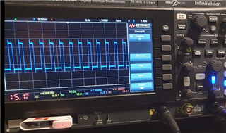

  • Ok, here it goes. I have this 4 layer board on which I designed the initial circuit. I totally forgot about this board because I moved away to USB-C PD.
    For some reason, in this PCB it seems I respected design considerations outlined in the datasheet.
    I have vias, I have 2oz copper and 4 layers.
    This is the (old) pcb setup
    However old, this seems to work (somewhat?) better.

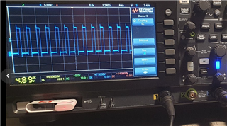

    I tested the 12V(VIN) line and 5V(VOUT) from the buck. I still have voltage drops on both.
    Although the voltage drops on the load, I observed that it didn't drop on the oscilloscope reading. You can see in the 12V video it drops down to 11.2 around max amps (the transformer is rated 12V 5A = 60W).

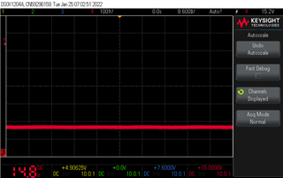

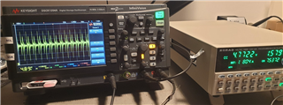

    Here are the measurements for the VIN (12V)
    And for VOUT (5V) on the oscilloscope, it remained relatively stable from 4.99 -> 4.96, but in the video, you can see it drops below 4V just before the chip shuts down.
    What is very important, I think, is that the chip doesn't break in this instance. Once I unplug the barrel jack connector and wait 5 seconds I hear a thin click and when I plug it back in it works normally. I repeated this about 5 times with the same result and same values drawn as in the video where I show the power drawn from VOUT.
    I now know the copper layers/thickness and vias make a huge difference. You can see that here I also used a better placement of the electrolytic capacitor. I must have had a bad day to come with the PCB I initially presented here (the second one was made about 5 months after). However, I cannot explain the voltage drop.
    The devices that I am using cannot work with a voltage lower than 4.95. Do you know have any clue what I might do wrong?
    Later edit: I thank you for your help and patience once again. I'm studying those components and working for a startup that is ready to expand and we will use a lot of those chips in our product.

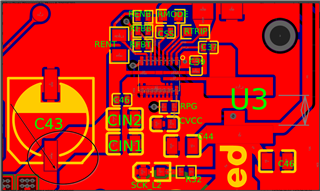

    Last thing I'm going to ask before I do a review of the board:
    Do you see anything on the PCB above from a layout point of view that needs changing?

  • Could you comment on this, please? Many thanks.
    AGND/GND is 0 ohm.
    The rest of the components are as spec'd. What do you think about the layout?
  • Hi, looks okay to me. Few things:
    - Make sure there are some vias connecting the power (input and GND) planes to the layers below.
    - I would also add a few more vias under the device pad VIN (pin 10, 21).
    - Make sure to trace widths are as recommend in the datasheet (Layout Guidelines)
    Alejandro
