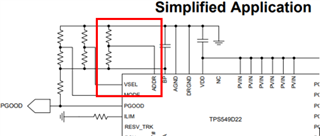

  • Hi Alec,
    Thanks for your reply.
    As per your comment #3, Pin 32 (ADDR) does not support a resistor divider.
    However, in the webench or datasheet, a resistor divider is used as shown below.
     1. Webench                                                                         2. Datasheet
    Does this depend on whether PMBus control is used or not?
    Which ADDR pin connection matches the customer's intention to use the TPS549D22 without PMBus control?
    JH
  • Hi JH,
    If the customer intends to use the TPS549D22 without PMBus control, then the resistor configuration on the ADDR pin does not matter. In that case, I would suggest leaving the resistors unpopulated to save on the BOM cost.
    Alec Biesterfeld
