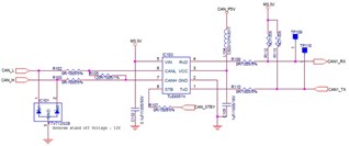

I have BCI Fail problems.
The application is Air purifier for Automotive.
I tested with CM Filter, LC Filter, MLCC etc... There is no any improvement.
Would you please give me advice..?

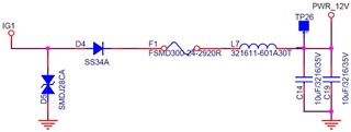

I attached Main Power input circuit and CAN Communication Circuit.
How can i make that OK for BCI test?

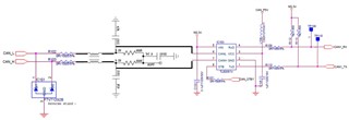

I am planning to add PI filter for Main power, and CM Filter for CAN Communication, as below.
Please share your opinions for them.
