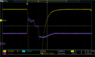

    I have finished my initial hardware evaluation.
    I was able to test with a crude transient test when operating with about 3.8A (each LDO  just under 2A).
    In this test, a brief mechanical short was added and released, and the recovery can be seen.  Fairly well damped response.
    In this plot, the Cyan trace represents current from both LDOs.  The purple trace is LDO1.  Note, the different scale for each.   Channel 1 has a 1V offset.
    The boards did not have as much capacitance as your design.    Each board had 1-220uF, and 2- 3.3uF for Cout.
    I can see if I can find some larger tantalums to place on this to get this closer to your capacitance if this would be beneficial.
    The setup has ~6in cross coupled wires for CS to PCL connections and the feedback to the second LDO, so this is not necessarily very clean.
    I attempted to run a non invasion stability check with the parallel combination, but the results did not make sense.
    Wade

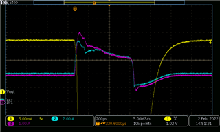

  • John,
    I have some additional feedback.
    I was not able to locate any of the larger tantalums locally.  However, I combined 3 220uF on each board.  This should somewhat resemble your total capacitance.  I have 6-T543X227M016ATE035.
    The transient response looked very well damped, and no oscillation.
    This was the same method, with a brief mechanical short.

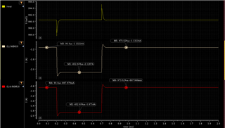

    Additionally our design team simulated with your conditions.
    This plot shows simulated transient response in your configuration with a 2A to 4A and back with 500ns rise/fall.
    Wade

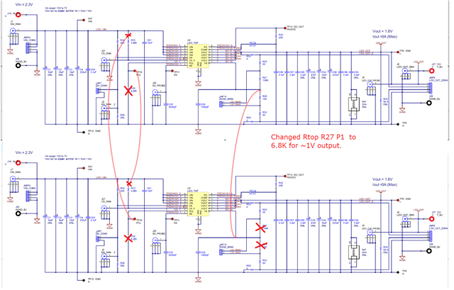

  • Thanks Wade, promising results.  I need to do an analysis of the pdn network between our loads and the bulk dcaps at ldo outputs to assess if the 500ns rise/fall time is reasonable approximation of our application. I'll follow up when i get that answer.
    While that's in process have some clarifying & confirming questions:
        1.) Did both the simulation & lab testing include 2xLDO's in parallel with ~3.74k between LDO2:CS to LDO1:PCL & LDO1:CS to LDO2:PCL with no resistors from CS to Vin nor PCL to ground?
    2.) Did the simulation use the PSpice model for the "A" part on the website (not WCA nor "Non-A" transient model), if not what model was used and can I get that model?
    3.) I take it from the lack of a bode plot in this thread a model does not exist for frequency response simulation of 2 ldo's in parallel, i.e can't generate bode plot for gain & phase margin assessment of 2 LDO's in parallel, correct?  Therefore must rely on presence or absence of oscillations in transient model simulation for assessing stability, correct?
    -John
  • Yes, I agree the results are promising.
    1)   Yes, except the resistance between CS and PCL was 3.65K, as it was already on the EVM.  Here is markup of the schematic.
    Simulation setup to match.
    2) Simulation used transistor model extracted from the design database.   This model is not available outside of TI.

  • John,
    Good news.  Was able to get stability sims run on the transistor model.
    The simulations used mis-matching with process between the two LDOs.
    Transient sims were performed with a 2A load stepping to 4A (shared).
    Bode plots were run with 4A shared load.   For the bode plots: PM ranged from 54 to 73 degrees.   Fc ranged from 57-100kHz.  GM was approx 33 to 37 db.
    Granted, this is not in real hardware.  However, this data along with good transient performance on less than ideal hardware should provide some confidence in ability to achieve a viable solution.
