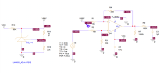

I am looking for a referrence voltage of 1.65V for op-amp.

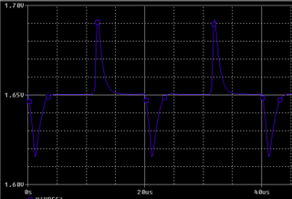

I did simulation with LM4051AIM3-ADJ, but when the load current changed, the VREF voltge changed as well.
Could you help have a look.
1. How to get a stable voltage by LM4051AIM3-ADJ, no matter the load current changing.
2. Any other IC soltuion to get  fixed 1.65V  referrence voltage directly.
