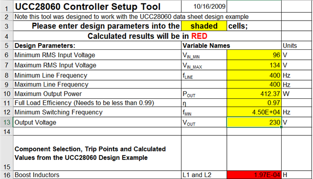

We are using the PFC IC UCC28060 (Transition Mode Two Phase Interleaved)
I am bit confused to select the optimized inductor for my application .
I did the Calculation for Inductor using TI datasheet UCC28060 , General Calculation and  TI Calculator sluc072b.
Since we are using the Critical Conduction or Transition Mode PFC , as per my understanding we need to use Lmin value. (Please correct if I am wrong)
If we select the Lmax Value then for certain condition Zero cross detection may not detected and one of the Mosfet won’t turn on this leads increase the power dissipation , inductor saturation and System may fail.
Please see below calculation and let me know Which Inductor value is suitable for my application.
