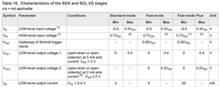

Hi, hoping for some more info. on TPS65217 regarding I2C: I've studied the datasheet and also the answer to this question, which basically states the datasheet information, but I cannot find the information I need on I2C electrical characteristics for the TPS65217. I need to know if the TPS65217 SDA can sink 2.5mA and still meet I2C bus specification. I need a higher sink current because I wish to use AM335x in Fast mode for another peripheral on the I2C0 bus (which is shared with the PMIC) and this means increasing the I2C loading. PMIC TPS65910 does meet the requirement (SDA Low [max] is 0.4 x VDDIO [3V3] for 3mA IOL) but we use both TPS65217 & TPS65910 in our designs, depending on availability. Thanks!
