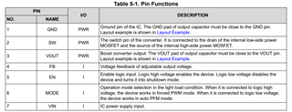

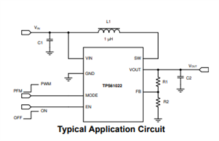

1.) For Pin 6, when this pin pull low, the device always work at PWM mode, when this pin pull high, the device will operate PFM mode at light load, but the normal load will operate PWM mode, do I understand right?

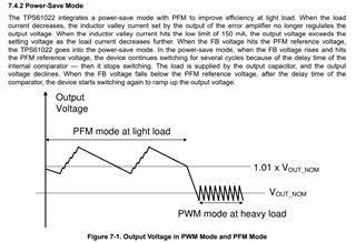

3.) I don't not very understand 1.01* Vout_nom, could you give me an example?
    [WW]No, your understanding is not right.
    When MODE is pulled low,  Auto-PFM: the device will operate PFM mode at light load, but the normal load will operate PWM mode
    When MODE is pulled high, FPWM: Always PWM whatever light load or heavy load
    [WW]See below: The application note/blog about PFM is planning to publish in 1Q22 soon, to explain mechanism of PFM, which a lot of people are asking now.

    For 3, do you have an explanation which talking about the work principle?

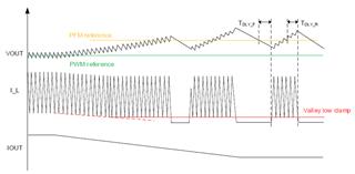

    Refer to below description in the app note.
    Figure 1 illustrates a simplified mechanism of PFM (Pulse Frequency Modulation) which has been used in TPS61022. PFM is one kind of PSM and helps increase light load efficiency. TPS61022 utilizes adaptive constant on-time valley current control. As which can be seen, initially output current drops, as a result, output voltage rises. Internal error amplifier decreases inductor valley current to response increased output voltage. However, when inductor valley current drops to low clamp, error amp is clamped and inductor valley current does not drop further.
    As the error amp is clamped, there is always energy larger than load demanded sourcing to output side. Therefore, output voltage keeps increasing. When FB hits PFM reference, internal comparator sets both FETs to be OFF after rising delay TDLY_R. When FB drops below PFM reference, comparator releases both FETs after falling delay TDLY_F. After that, the clamped EA ramps inductor valley to the low clamp and output voltage increases. The delay is not intentionally designed and is unnecessarily considered in real design. Output ripple in PFM has been simulated across corner cases to be 30mV(typ.) and 50mV(max) under datasheet’s recommended operating conditions.
