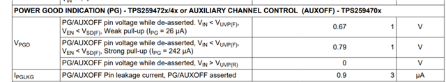

Good day.
Our customer this question regarding the TPS25947:
We are using the particular part no TPS259472ARPWR in our design. For that part no, pin no 3 is PG. We are in need of VOL values needed for design purpose. Can you please mention VOL maximum value for that pin PG.
Can you please help us? Thank you.
