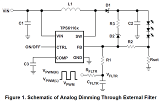

I have a question about the TPS61165 analog dimming schematic.
SLVA471.pdf (How to Use Analog Dimming With the TPS6116x) Figure 1.
I couldn't understand the need for a D1 Zener diode. In what cases do you recommend this circuit?
In the case of analog dimming, open detection does not work, so do I need a D1 Zener diode?
I couldn't understand even if I looked at [4 Using a Zener Diode to Protect Against Open LED Condition].
Should I always attach a D1 Zener diode when performing analog dimming?
