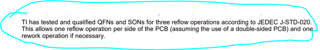

Hi Taketo,
There is no specific guideline for TPS259472 device. But there is a app note talking about QFN package. Please refer section 5.2 Solder Reflow
https://www.ti.com/lit/an/slua271b/slua271b.pdf
