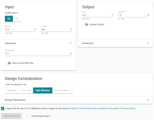

  • Hello Slava,
    If you full-wave rectify the input voltage, then the most logical solution is to use a buck regulator.
    I used Webench Designer assuming 24Vac with +/- 10% input and chose High Efficiency as a target.
    Webench returned 362 possible designs.
    To narrow the results, I then chose 87% to 92% efficiency, and 700kHz to 1.3MHz switching frequency.  I then had 3 designs.
    I then chose a design using the LM60440D because it had the highest efficiency (91.9%) and a 1MHz switching frequency.
    I recommend trying Webench.  You can decide if you want lowest cost, smallest footprint, low or high switching frequency, etc.
