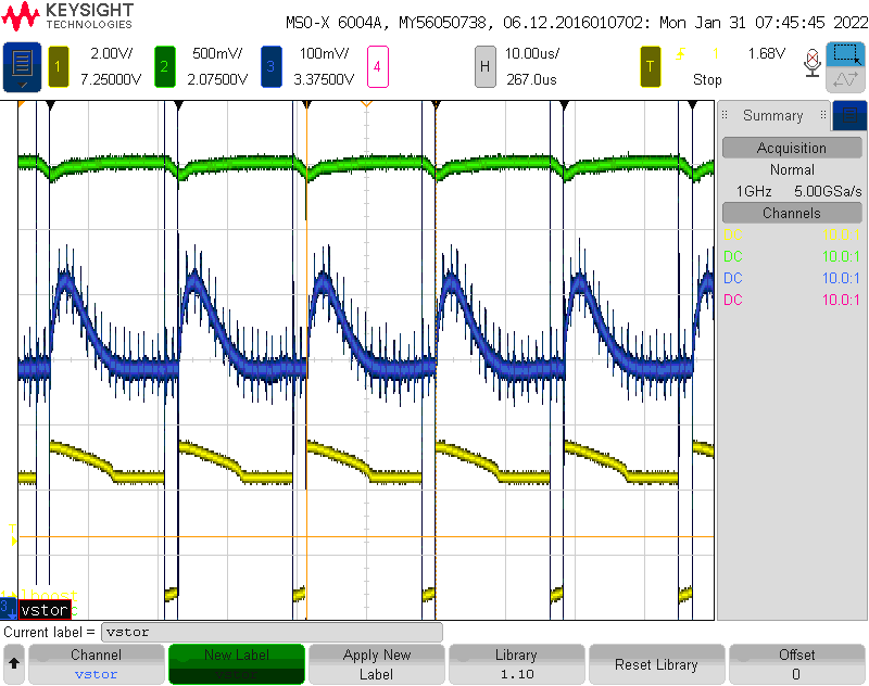

    Is the BQ25570 boost converter still switching when VIN_DC=3.6V and VBAT_OV=3.3V?  Can you send a scope shot with VINDC, LBOOT and VSTOR like the one below? You can leave off the inductor current.  And then also a plot of VRDIV like below?  Note that your VRDIV plot will have a second for VOUT not shown below.

  • Hi Jeff,
    Please find attached the scope traces you requested,
    Thanks, Gavin
  • Hi Gavin,
    On the top plot, is the yellow supposed to be LBOOST pin?  If so, it looks wrong.  It should be rectangular pulses like the green plots in figure 26.
    On the bottom plot, the second pulse should be 2/3 of the VBAT_OV setting and the third pulse is the VOUT regulation point.  That appears correct, yes?
