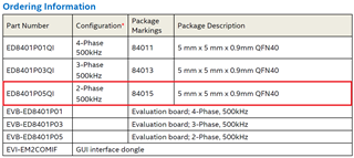

Customer is consulting whether we have compatible PMBus Power Controller solution(2-phase) w/ Intel ED8401P05QI? The D/S is attached below. Pls help us here.

Hi Derrick,
P2P is better. If not, similar function one is also okay. Pls see below screenshot description:
Stanley
Stanley,
We don't have the pin-to-pin solution. If you only need 2-phase w/ PMBus, then TPS53622/TPS53622A is good to use. It's been used in VR13/VR13HC platform widely.
