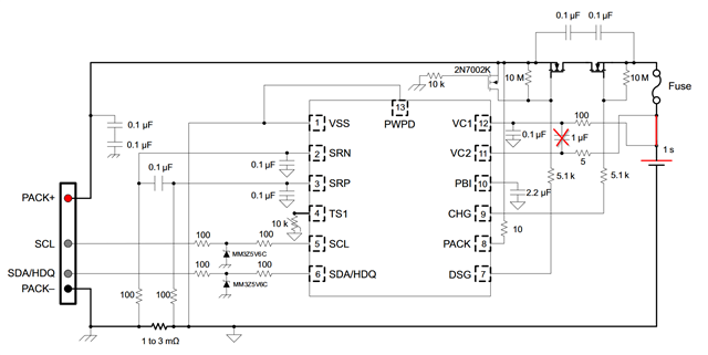

Hi TI team,
We already use the BQ78Z100 in a 2-series cell configuration and now we are planning to use the same IC for a single cell configuration.
I don't find any datasheet recommends if the resistor/capacitor need to be removed for the unused channel?
Do I have to connect the unused cell input VC2 to VC1 or is there any issue?
Do you have any recommendation to use this IC for a single-cell application?
