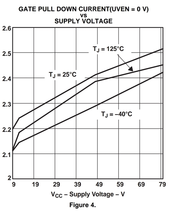

i'm experimenting with TPS2492.
I need to know if the current highlighted in figure is approximately stable or have a variability basing on the different PN?
if this signal has been characterized it is possible to have details about this?
Alex
  • Hi Alex,
    Thanks for reaching out.
    The Gate pull down current is a function of Vcc supply voltage. Please refer figure 4.
    Including process the Igate variation is from 1.8mA to 2.8mA. It is mentioned in the electrical characteristics table.
