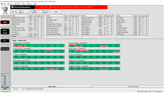

The cycle value of bq3060 becomes larger (58752), which should not exceed 10. What are the possible reasons

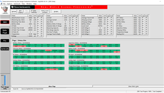

Here's another question about current register of BQ3060, There is a 1% probability of abnormal of this register, when the register is abnormal,it display about -18mA(it should be 0mA),What is the possible reason for this? Is it also related to static electricity?
Hello Jinxing,
It may be possible for the calibration to be damaged as well, leading to incorrect current readings which may increase your cycle count. This would also cause issues with the gauging if the current reported was abnormal.
Can you share a .gg file from the "bad" pack and a "good" pack?

Hi Sir,Sorry for the previous wrong information,Please check the attached file this time,Thank you!7167.gg.zip
Hello Jinxing,
I don't see any abnormal values between the two, does the cycle count always jump to near the same value? I see the CC gain CC delta and CC offset are all different, was it calibrated differently?

Hi Sir, it calibrated differently, I am not sure if the wong number of cycles are same, so can you find out something lead to wrong cycle number from the gg.file ?
