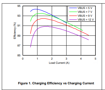

    Please note, as shown in the efficiency curve below, that with input current set 3A max, VBUS must be higher than 7V when VBAT>3.8V in order to get >4A charge current.  Also, the charger has thermal regulation that reduces charge current if the die temp gets above 120 C.  So, having the IC ground pad connected through to as much copper as possible is critical.
