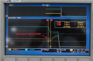

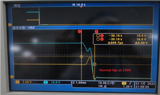

     I use the load to discharge the battery pack 250A, trigger the SCD protection, the Vgs waveform of the MOSFET looks normal.
     But when we increase the current to 300A, trigger the SCD protection,
    the Vgs waveform of the MOSFET will first drop to 7.7V, then rise to 15.5V, and finally drop to 0V. What is the reason for this? This can easily burn out the MOSFET.

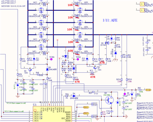

  • TI experts,
    1. What is the withstand voltage of capacitor C23 of CP1? 14 strings of 60V batteries, can C23 use 50V capacitors?
    2. Can the CP1 capacitor be increased from 1uf/100V 0805 to 2.2uF/50V 0805?
  • TI experts,
    Will the capacitors C26+C27 of the SRN and SRP pins affect the SCD? Can these 2 capacitors be removed?

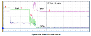

  • Hi Jmyang,
    I have not encountered the drop in Vgs during SCD although I seldom look specifically at Vgs. The circuit behavior at SCD might be described in several phases marked on this figure from the application report https://www.ti.com/lit/pdf/sluaa09
    As an example, not matching either the example figure or your images:
    1.  Normal operation, DSG is on, charge pump is on in the high voltage mode
      1. BAT+ = PACK+ = 50V for example
      2. DSG = approx 61V
      3. Discharge FET Vgs is approximately 11V, perhaps 10V if the circuit has a diode like your D7
    2. Heavy/SCD load applied
      1. BAT+ = PACK+ = loaded cell voltage, 10V for example
      2. BAT pin of BQ76952 is held up by filter capacitor (your C19, C20), discharge to BAT+ is blocked by D1.  C23 holds up CP1 at approximately 61V
      3. DSG is driving to CP1 voltage of 61V, but current is pulled out of the pin by the DSG resistor network (your R72 etc),.  DSG current is limited to approximately 10 mA, so DSG pin voltage will drop to some level below the 61V.  In figure 6-24 above note it drops slightly, this will happen as the BAT pin filter and CP1 capacitors discharge
      4. The FET gate-source capacitance will initially pull down the gate voltage, but the current out of DSG will charge the capacitance and the voltage will rise until limited by the gate-source Zener attached (your Z10), typically 16 to 18V where it will limit.
      5. So Vgs would be expected to rise from 11V to about 18V during the SCD load
    3. The part times out the SCD delay and turns off DSG.
      1. At turn off DSG is pulsed, pulled toward VSS until below LD.  LD should be at the PACK+ level which is the source of the discharge FET.
      2. Vgs should drop through current into the DSG pin and/or current through a turn off transistor such as your Q5
    4. The discharge FETs turn off
      1. As the discharge FETs turn off and current is reduced, the load on the cells drops and the BAT+ begins to return to normal
      2. The cells and interconnect experience an inductive response added to the unloaded cell voltage of V = L x dI/dt causing a peak in the BAT+ voltage
      3. PACK+ voltage falls to PACK- (0 V) due to the load.  If the load or short circuit is inductive PACK+ may go below PACK-
    5. The inductive transients die out, discharge FETs are off
      1. DSG is low, at or near VSS
      2. BAT+ is its normal open circuit voltage, cells may be recovering from the heavy load, 50V in example.
      3. PACK+ is low, 0 V, at PACK-
    Again I have not observed the drop in Vgs.  DSG should be higher as noted in the description.  Q5 should not be able to pull down Vgs.  One thing to look at is whether the sudden drop in PACK+ may cause a capacitor divider effect between D10 and Z9 to partially turn on M1 causing the dip in Vgs.  You might try removing R78 or R79 as a test to see if the Vgs is eliminated.  If yes there may be several ways to slow response of M1 turn on.

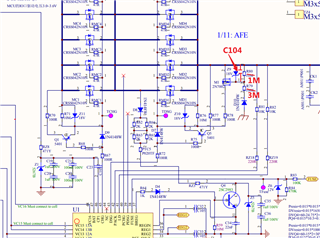

  • Hi  WM5295,
         After I removed the R78, the DFET's Vgs didn't have a falling waveform anymore.
        In the new circuit, do you think I can adjust it according to the red words below, is it feasible?

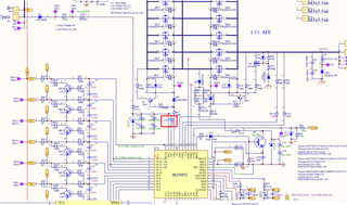

  • Hi  WM5295,
        The Vgs voltage of the DFET is too high, reaching 19.7V, as we know, the Vgs of the DFET is up to 20V, which is easy to damage the DFET, right?
    How can I lower the Vgs voltage of the DFET?
        My circuit is below, waiting for your comments.

  • Hi Jmyang,
    Since removing R78 eliminated the dip it is apparently the clamp turning on unexpectedly causing the dip.
    In the new circuit C104 will resist movement of the M1 gate when Pack+ changes suddenly.  C104 should be "much" larger than the D10 capacitance.  Large resistors like the 10M R80 would make the clamp turn on and off slowly.  There are a few considerations for the clamp with reverse voltage:
    • When PACK+ starts to go negative you want the clamp transistor to turn on in time to prevent discharge current from the main path.  So your voltage divider of R79 and R80 will normally put most of the reverse voltage across the gate-source of M1, or R80 is typically large and R79 rather small (see the EVM).  You likely don't want a situation where if the user applies something like -12V and the M1 does not work and the battery continues to discharge.
    • When the pack has a reversed charger attached you want the clamp to hold the gate-source voltage of the power FET below its Vgsth level.  So if your normal charge voltage is 60V and the user somehow connects that in reverse, there will be a voltage divider from the DSG pin at 0V to the PACK+ at -60V.  In your circuit that will be through R72, D7, R78, and M1.  Since M1 is on and ignoring D7, it will be basically between R72 and R78, so you want R78 small (the EVM did not have a resistor) and R72 (the EVM had about 10k).  I know you are adjusting values, but these both show 100 ohms at present  That would give about -30V on the gate, so the power FET would come on and not allow the PACK+ to reach the -60V level.
    • Consider the power dissipation of the resistors in the reverse voltage scenario.
      • For R72 (with small R78 so the power FET turns off), most of the negative voltage goes across this resistor so it must be sized for the power.  For the EVM a large value was used, and a diode was used so the effective turn off resistance was smaller.  When driving a lot of FETs turn on does slow due to that larger resistance, consider a circuit similar to figure 6-21 in https://www.ti.com/lit/pdf/sluaa09 if you need the low resistance for faster turn on.
      • For R79, it will have about the reverse charger voltage minus the Z9 voltage minus the D10 forward voltage.  The power comes from the reverse charger, but consider the resistor rating and the heat in the battery.
    • DSG on the BQ76952 is not intended to and will not go very negative. If much current is pulled from it it can violate abs max.  If there is much current pulled from the net consider the D10 Schottky shown in the EVM.  Consider similar diodes for LD and PACK pins.  These were not populated on the EVM.
    • If the pack inductance is large for a short circuit like event PACK+ can go below PACK- in transient and the clamp circuit can come on.  In this case you may want a resistance like R78 with a similar value to R77 to avoid a very fast turn off and resulting cell inductive voltage response.  Just remember the R78 value must be balanced against the R72 value as noted above.
