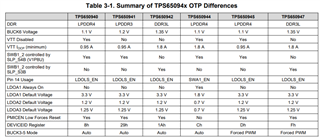

Does our device support intel SOC A3920?

Hi Sherry,
Thanks for reaching out! Some of the TPS65094 E2E in the past few weeks were accidentally assigned to a different person and have been re-assigned. We apologize for the inconvenience and delayed response.
The TPS65094x PMIC comes with the default OTP configuration, specifically to support the Intel Apollo Lake Platform which integrated E3900 processor series. I would recommend reviewing table 3-1 in the datasheet to identify the TPS65094 variant would be the right fit for the application.
I'm also including other links with technical information that will help support a design with this PMIC:
