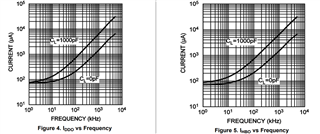

Dear Leslie,
Thank you for your support, and sorry for later reply.
Actually I don't understand clearly about it. could you give me some example if the ambient temperature is 70 degree?
and i saw the graph in the datasheet below;
the curve ends near 5MHz, and no curves after 5MHz. so it seems like it does not support over 5MHz.
could you give me your opinion about this?
Chase
Hi Chase,
The 5MHz just indicated that the data was collected up to 5MHz. The power consumption of the driver is what determines the maximum achievable frequency since the temperature rise must stay within the device's operating temperature.
