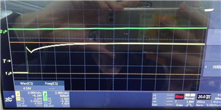

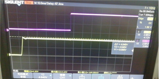

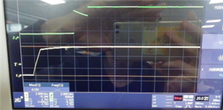

  • (Yellow AC input  Green SYS  output)
    Power supply KXN-305D: cannot start normally when the power supply is set to 4.6V
    Power supply KA3005P: start normally when the power supply is set to 4.3V
    Power supply KXN-305D: start normally when the power supply is set to 4.7V

    Thanks for reaching out! I have reviewed the waveforms provided in the previous message and it seems like something is pulling the AC signal below below the "voltage-removal detection threshold" (UVLO+OFFSET = 3.3+0.2=3.5V) during power-up. Could you provide the following information:

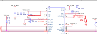

    • You mentioned USB is connected to GND. What about the battery pins (BAT, BAT_SENSE, TS)? How are those connected?

  • Hi Brenda
    Thank you for your response!
    Sorry this picture depicts wrong, this can't be started
    1.BAT, BAT_SENSE are shorted and connected to GND through a 10K resistor
    2.using ceramic capacitors,part number
    3.YES Except these 22uF
    4.yes checked
    5.TPS65217CRSLR

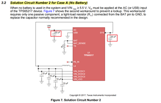

  • Hi Felix,
    We recommend 22uF cap in the SYS pin. Is your design based on the BeagleBone Black with the brownout solution circuit added? The spec parameters that defines SYS during power up are the voltage-detection threshold, the rise time and the power detected deglitch. If the voltage on AC studently drops during power-up before reaching the detection threshold (4.3V), this could affect the rising time causing the signal to exceed the 50ms rise time. The last scope capture you shared doesn't show a brownout issue because you are able to get a voltage on the SYS pin coming from AC (PMIC doesn't experience lockup). Could you provide a clear scope capture (where I can see voltage and time scale) showing AC, SYS, VIO and and VLDO1? Are you supplying VIO with the PMIC VLDO1 or an external regulator is being used?
    For your reference, the voltage threshold that matters during power-up on AC is 4.3V. Once it exceeds 4.3V, the voltage threshold that matters when the voltage drop is UVLO+OFFSET.

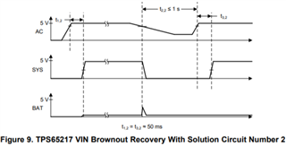

  • Hi Felix,

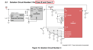

    If you have an application without battery, where VIO is supplied by VLDO1 (from the PMIC), then you can implement the solution circuit number 2 in the brownout report (Designing Robust TPS65217 Systems for VIN Brownout). You could also add the supervisor + load switch to the AC pin. To understand the solution circuit, please keep in mind the Brownout issue is all about input voltage dropping during operation. It doesn't really relate to power-up. The idea of implementing a supervisor+load switch is to prevent a brownout on the PMIC by detecting a UVLO ahead of time. That's why the UVLO on the external circuitry has to be higher than the voltage-removal detection threshold on the PMIC so it can disconnect the external source before UVLO condition is detected on the AC pin.
    which will cause that if the voltage rises to 4.2V, neither the PMIC nor the anti-power-down circuit can function
    Not sure if I understand this last comment but 4.2V during power-up doesn't mean anything for the PMIC. Just for your reference, the table below shows the threshold voltages for the supervisor that is recommended on the brownout report.
    https://www.ti.com/product/LP3470A
    Brenda
  • Thank you for your reply, because I was on vacation a few days ago, the reply was not so timely

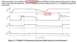

    To understand the solution circuit, please keep in mind the Brownout issue is all about input voltage dropping during operation. It doesn't really relate to power-up. The idea of implementing a supervisor+load switch is to prevent a brownout on the PMIC by detecting a UVLO ahead of time. ” GET

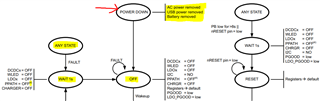

  • Hi Felix,
    Below is my feedback to your questions. The remaining items you listed above are correct.
    After that, as long as the AC is greater than 3.5V, the PMIC can work normally without entering an abnormal state (only focus on the power supply here)
    Yes, but but to be more clear I would replace 3.5V with "UVLO+OFFSET". UVLO is a threshold that can be re-programmed on the EEPROM. If it is 3.3V, then the voltage-removal detection threshold would be 3.5V. As an additional note, the UVLO accuracy is +/-2%.
    6. It is necessary to ensure that the drop time is greater than 1S to ensure entering the PRE OFF state
    This PMIC (TPS65217) has a 1 second fault times after it exit the Active state. If the supply at the AC pin drops below UVLO, it must be kept low for >1s (at least 2s recommended) before it recovers to make sure the voltage recovery is detected. This is the reason why the brownout report recommends a load switch+supervisor.

    Not sure if I understand this question. How long does it take to turn OFF the AC input? This is controlled externally. It will depend on how fast the external supply drops and the input capacitance. If you have additional external components between the supply and AC pin (i.e load switch+supervisor) then it will depend on the timing parameters of those ICs.
    If your question was how long it takes to turn OFF the PMIC, there is a wait time of at least 1s from Active to OFF state.

    This is OK. If you will be implementing the supervisor+load switch, I don't see any issues with enabling the load switch (to connect VIN to AC) 100ms after VIN is 4.3V as long as the AC pin is kept low for >1s when it drops below the removal-detection threshold.

  • HI Brenda
    My usage scenario does not require the use of batteries, which corresponds to case A in the slva901.pdf document, and the solution for adding load switches is for case B and C. I understand that in the case of no battery power supply, as long as the AC is powered off When it reaches 0V, the PMIC can return to the default state of unpowered, no need to use the load switch to delay more than 2S to avoid entering the BAT power supply mode

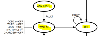

  • there is a wait time of at least 1s from Active to OFF state.
    I tried to search for the source with 1S in the TPS65217 data sheet, but I didn't see the description of this piece, can you tell me which manual it is on which page, thank you very much
  • Hi Felix,
    Here are the responses to your questions in the last two messages above:
    Yes, your application/scenario corresponds to CaseA. As I mentioned before, since you are already using the AC pin to supply the PMIC, solution circuit 2 would be the right one to implement. If you also wanted to add the load switch+supervisor to the solution circuit 2, that would be perfect. It will not affect the solution but instead will add more reliability to the system by isolating the AC supply for >1s in the case of an UVLO event. Below is the waveforms for solution curcuit#2. As you can see, it helps to make sure the voltage on the SYS pin reaches 0V after an UVLO event. If you add the load-switch+supervisor, the voltage on the AC pin will fully drop to 0V and will keep it low for >1s.
    The 1s wait is specified in the device functional modes in the datasheet as in the Brownout report.
    From Brownout report:
    From Datasheet:

    A.As shown in the waveform diagram you provided, the load switch circuit is in the state of undervoltage. If I use the MOS switch to turn off the only power input: AC, the PMIC has no power supply at this time, why does it take 1S? What I mean is that the premise of the state diagram of the manual is that there is at least one power supply path for the device, and if I turn it off by means of the MOS tube switch, I no longer need to wait for the time in the state diagram for 1S, I don’t know if I do this understand correctly

  • Hi Felix,
    From your previous messages it seems like solution circuit#2 and solution circuit#3 from the brownout report are getting mixed. Please note that solution circuit#2 is the one that better matches your system needs because you are not using a battery and VIO is being supplied by the PMIC VLDO1.
    The supervisor + load switch is present in the solution circuit#3 because when the AC voltage goes below UVLO the PMIC is still connected to the BAT voltage as well as the external regulator supplying VIO.
    What will happen if all the power sources (including BAT) are removed from the PMIC? It will just shut down. The 1s wait time would not be applicable. See a capture of the global state diagram below. Just like I mentioned before, if the supervisor + loadswitch is added to any of the solution circuits it will not have any negative effect on the PMIC response. It will just hold the AC pin low for a time period configured in the external ICs.
    Regarding your question on the UVLO setting, TI recommends adjusting the UVLO of the TPS65217 device to the value required by the chemistry of the battery used. When a battery is not present, the lowest UVLO voltage reduces the chances of a brownout condition occurring. If your application does not use a battery, then the lowest UVLO (2.73V) would be the right setting. If a supervisor + load switch was integrated in your solution circuit, the UVLO detected by the external ICs doesn't necessary need to be 4V specifically. It just needs be higher than the UVLO+OFFSET in the PMIC.
