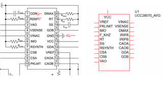

While trying to import the pspice file I am noticing that Gnd, Pklmt and Ref pins are not in the .subckt file
Any comments?

Hi Jacob,
I see REF (VREF) and PKLMT (PKLIMIT) to the left of your first arrow. GND is implicit.
Ray
Sorry i miss that
However while trafering this pspice model to simetrix , i don't know how i will reconfigure the missing pins CDR,RDM an GND. The picture in Red color is the symbol iam getting thru the simertrx model conversion process

Hi Jacob,
These models were created years back by our modeling group. The best explanations I can find regarding CDR, RDM, F_KHZ, IRIPA and IRIPB are from their E2E posts. Here are several below:

Ray,
Myunderstading after reading the attached link is that , the model i tried to use is an average model and i canot used it in transient as a model for transient simulation. How ever in one of the link it says there is a published transient model available. Can you help me to get transient model for the above part
Jacob
Hi Jacob, I believe the average model of the part would also be used for transients simulation configuration. I do find some other simulation files in our repository, including some load step and line step (transient sims) and they just use the average model.
So, to my knowledge, there is no difference in the controller model for the different sims.
Let me know if this make sense or if I may be missing what you're looking for.
