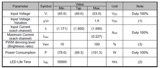

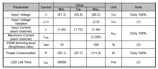

My customer would like design LED driver with DC dimming function.
Would you please review two design case with LED spec and provide your comment?
 if TPS92691 is not good option, please let me know what we can recommend. thanks for help!
  1. 10 string, 16pcs LED/string in parallel
        2. 10 string, 18pcs LED/string in parallel

    currently, customer do not has the LED spec.
    customer would like to confirm whether TPS92691 support DC dimming function in generally or not?
